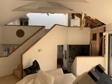

We recently had a fire in our home with a decent amount of damage due to a faulty chimney liner from our wood stove. Fortunately everyone got out fine, and the additional silver lining is that we're doing a complete rebuild of that part of our house. Our home is a 2,500 sq ft contemporary with 2.5 levels. Picture #1, on the left, is a view from the living room, which is on one side of the house. The kitchen is on the lower floor on the right, dining room on the left (hidden by the upper staircase). The spot for the wood stove is on the first floor, behind the half-wall on the right side of the picture.

We have been using our wood stove since we bought the house a few years ago and love it. The location of our stove such that we can't really sit around it, so it's more functional rather than decorative, though it's in a very visible spot when we're in the kitchen or dining room. The heating from the stove is definitely good for the living room and the master bedroom (the open door on the right side of the second floor in Picture #1, right above the stove spot), which sometimes gets too hot at night if we're not careful about controlling the fire. The heating is solid but not as good for the kitchen and dining area, which are on the same floor as the stove. I guess all that's not surprising, since there's no ceiling right about the stove so most of the heat rises straight up.
