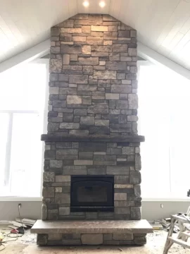

We just built a new house and went through the same process as you are now. We didn’t think we would use the fireplace as our main source of heat but once you start burning it’s hard to go without that flame flickering and the coziness of wood heat. Our criteria was good quality, could heat the entire house if needed, didn’t increase insurance rates, and needed to give the ambiance we wanted while keeping the glass clean (I hate a smoked up glass.) Our house is just shy of 3000 square feet not including the 1800 square foot basement. We put the fireplace in the dining room as that’s where most of our entertaining goes on. We installed the Pacific Energy Fp30. It seems to be the perfect fit for us. Great fire show and puts out heat when needed. Not the longest burn but usually enough coals in the morning to restart. Our house is extremely well insulated and a week or so back it was -38c here, -49c with windchill and this fireplace kept the house comfortable without the furnace kicking in and that was using white poplar wood. For warmer days the heat dump works great to transfer some of the heat to the basement. I’ve attached a pic of our install. It’s quickly become the one thing we are most impressed with and wouldn’t go without in the house. Hope this helps.

Jdbs, that is a great looking setup. Much more elaborate than ours will be.

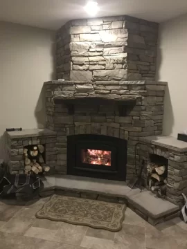

Those FP30 installs above look great. I appreciate any info you guys can provide on the Pacific Energy units.
