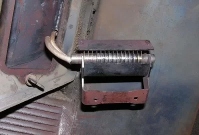

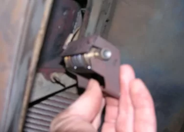

Had the tech today to replace the ignitor.
This ignitor is a bit different than the older ones.
For one it has extra protective cover on the wires and it has 15 rings compared to the older ignitors that had 10 I believe.
It seems to use the same wattage as the older ones judging by my kill-a-watt reader.
I've attached a couple pictures of the new ignitor.
Sorry for the blurry picture. It was just to show the fat plate on the igniter cradle is installed correctly. :)

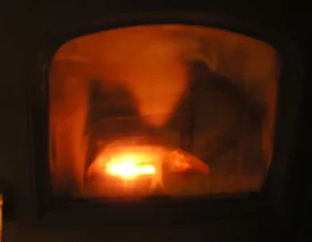

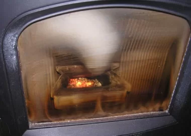

I've included two pictures of the stove because something peculiar happened when I started the stove and I will have to verify if this was just a fluke or if it happens all the time.
I put the ignitor back in place, scrapped the burnpot nicely and of course the burnpot it was empty when I started the stove.
After it started it started feeding pellets. With the new ignitor it took 4 minutes to fire up the pellets.
It had barely stopped feeding when the fire started and the pellets filled just about half the burnpot. That is the good news.
The bad news is that the fire didnt build up enough and the ignitor was on for a total of 11 minutes altogether.
I suspect that the reason was that the heat sensor must have not detect enough heat coming, because the burnpot was barely half full and it was not being fed for several minutes so the fire was not hot enough.The picture show the kind of fire that was going on.
When the feeder started again, after a couple cycles it fed enough pellets for the fire to pick up enough to turn the ignitor off.
I dont think this is normal but I will check future ignitions to see if this happens again. It was weird.
And yes when I do a deep cleaning (everytime when the ash pan is full) I do scrub the heat sensor with a brush. :)

you were probably getting the same ignitor replaced each time and they were prone to failure until they came up with this most recent design. they did not have a proplem for a long time and the manufacture of the ignitor changed the specs on the coil causing failures but they did not get this resolved untill recently.
But also for do it selfers and also techs it is important to put them in the proper way and have they wire facing to the right so as not to kink, also pulled back to the rear so the high temp wire is all that is inside the chamber, also the removeable retainer plate holding on the ignitor is on properly as it will go either way but one way will prevent the ignitor making good igniton and will take longer to light causing the smoke to builtup and get the mini bank when the smoke ignites.
