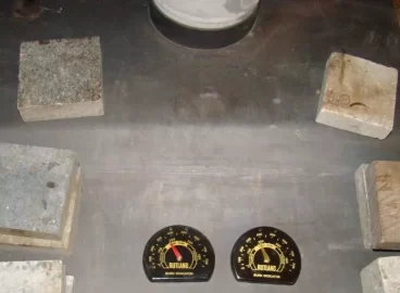

BeGreen said:Is that a galvanized pipe? If you reverse them, do you get the same readings?
PLAYS WITH FIRE said:My rutland, identicle to your's, is 80 degrees off. Get a pot of water, just before it is a "rolling" boil, dip the thermometer in the water until it is rolling. Don't set it in the water, dip it. If you set in the water it will contact metal and read the temp of the pot and burner. Mine was 80 degrees off....
You may be still overfiring, that I can't tell you but you can synchronize the meters.
shawneyboy said:Galvanized pipe as stove pipe can equall out gassing from pipe and very, very bad things. Well at least if you want to breath.
SmokeyCity said:PLAYS WITH FIRE said:My rutland, identicle to your's, is 80 degrees off. Get a pot of water, just before it is a "rolling" boil, dip the thermometer in the water until it is rolling. Don't set it in the water, dip it. If you set in the water it will contact metal and read the temp of the pot and burner. Mine was 80 degrees off....
Are the thremoms adjustable ?
ziggy19 said:my guess is the thermometer you have on the deck is made for your flu reading so if that would be the temp you would be getting on your flu you would be over heating. What temp do they consider over firing?
BeGreen said:I'd put them side by side on the stove top and see if they agree with each other. These are not exactly precision instruments.
SmokeyCity said:ziggy19 said:my guess is the thermometer you have on the deck is made for your flu reading so if that would be the temp you would be getting on your flu you would be over heating. What temp do they consider over firing?
both say > 550 is overfire
Yep 550 overfire would be a temp sensor made for a flue.ziggy19 said:SmokeyCity said:ziggy19 said:my guess is the thermometer you have on the deck is made for your flu reading so if that would be the temp you would be getting on your flu you would be over heating. What temp do they consider over firing?
there you go, 550 reading on the stack would be too high and your stove, temperature would be 700-750 give or take. but 550 for your stove box is A OK!
ANYONE else agree?
BeGreen said:550 overfire is for the flue, not the stove top. Those temperature ranges are for when it is used as a flue thermometer.
Before, (did you remove the picture?) I thought you had the thermometer on the stove's top step and that put the reading in the higher range. They read fairly close together at 550F, lets see how they read side by side on the hotter location.
SmokeyCity said:BeGreen said:550 overfire is for the flue, not the stove top. Those temperature ranges are for when it is used as a flue thermometer.
OK so I can expect that the deck is hotter than the stack? yes ?
If so then im OK
