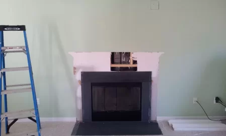

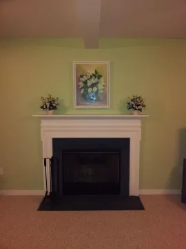

This is the original fireplace and mantel.

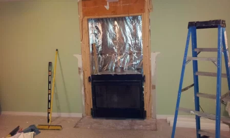

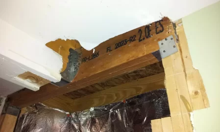

We ripped out the mantel first, then opened up the wall.

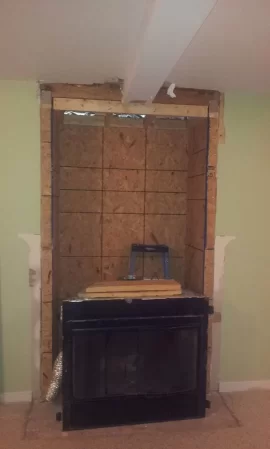

There we found our first issue - the header would make the ceiling height too low for a standard installation... and I had no desire to try an alcove install, so we had to move it.

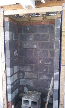

This is the finished chase...

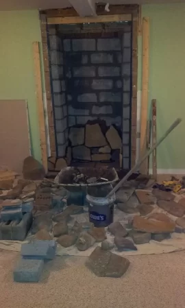

Now, for the brickwork, with the appropriate 1-inch air gap, of course...
But can't leave it looking like that... so we decided to do stone veneer.

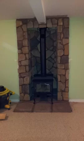

The Endeavor fits the space like a hand in a glove - clearances within a couple inches on any given side... but it fits!

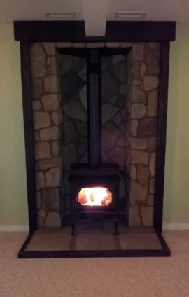

Here's the first fire - and we've had plenty since!
We're a happy woodburning family now... haven't run the heat pump yet this winter, and loving every minute!
