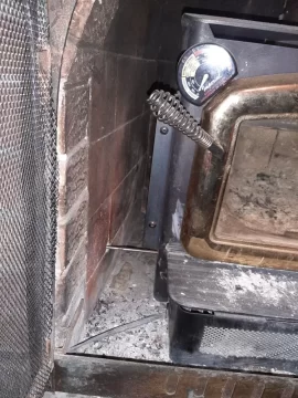

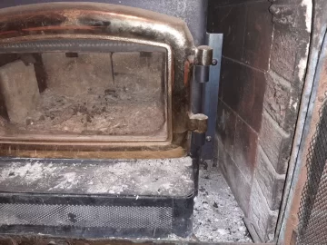

So the brick walls obviously get very hot. I was thinking about placing some duct work with a fan (essentially two diy blowers on each side of the insert) against the walls to reclaim the radiating heat that gets lost in the bricks.
Good idea? Poor idea? What do you think.

Do you have a blockoff plate? I would put some foil faced ceramic wool insulation behind it also

Cut the fireplace door lip (metal) and pull the insert out of the hole some. Use some 45s or similar if the liner wont match up.
I'm not sure I can move the insert forward without hacking away at some of the brick work. I tried using a 45° elbow when I installed the unit a couple years ago but it didn't line up properly

I just looked at the pictures again. That insert is way back in the fireplace. I would change things so it can be pulled forward like mark said. Also do you have a blower for it?
