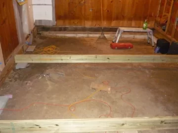

Just a few short months ago the house looked a little something like this...
In between the hole in the middle, and the pile of concrete rubble is where the stove sits now.
