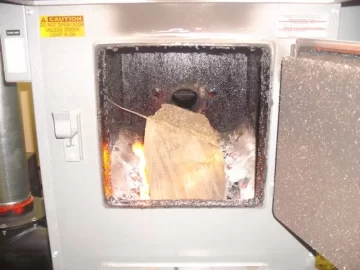

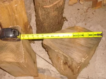

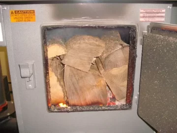

I will try a few large splits of Ash tonight with a few medium size ones as well. Hopefully you can make out the size in the pictures. 20-22" in length. The door is 14x14.

Your enthusiasm is very evident in your posts, and it is contagious! Your Wood Gun combustion chamber is similar to what I have. I think I'll give some larger pieces a try tonight.
