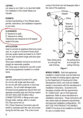

- CLAIM 1 - Galvalume/Galvanized Class A and Stainless Steel Class A can not be used with each other because they will cause electrolysis and I will fail my inspection if I do so. (I planned on using the galvalume in my attic space, and then transitioning into Stainless once out in the open)
- This one is less important, although annoying because I bought the Chimney pipe already from a retailer in Portland OR and now I'm being told by someone else that this is wrong.

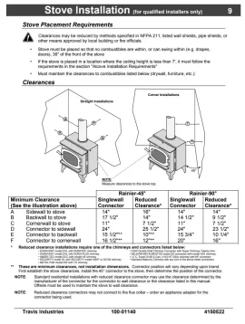

- CLAIM 2 -If the stove instructions say that the chimney pipe needs to be 10-1/4" off combustibles, that is what you have to follow, rather than the pipe manufacturer instructions that say 6" clearance to combustibles.
- This one if more important to me because, my stove pipe goes up at a very slight angle, and by the time it will enter into the support box, the stove pipe will be 9.5" off the wall, and the back wall of my stove pipe will be 9.5" off the wall (the stove pipe is inset 3/4" from the back of the stove). I can not move the support box away from the wall as framing members prevent me from doing so.
