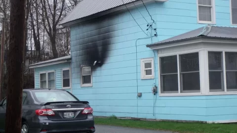

Saw this today in town...wow what a mess...hope they fix this...what the hell is going on...I should go over and help this person out...

That is nasty, if you do assist check the termination, could probably use a directional one or they may have to go out further or up to the roof with it. Many bad signs here.:eek: or maybe paint his house black.
If i was the one doing the install on that one i would have gone up past the eve
yikes!
and that sure doesn't look like a foot above or four feet from that window.
From the looks of it the vent is into the prevailing wind direction as well as being to close to the window (unless it is nailed shut) among other things including a poor air/fuel mixture.
also a poorly maintained stove.....certainly the termination is too close to the window, but not likely the cause of the soot on the home. Prevailing wind would be a biggie, tho. I would nix the end cap, and stick on a straight jet cap, or a simple 45.....heck, maybe even extend a bit away from the home...not like its gonna hit a lawnmower or anything when someone's working.
just have to account for where the snow and ice slide off the roof when extending pipes.
mine sticks out a couple inches. but is up closer to the eaves. and the snow slides away from the roof a bit when it falls.
Just want to point out that certain stoves allow the vent pipe to be within 18 inches horizontally from a window as long as an oak is installed.

yea, Subtle, and I squinted hard at that pic, and couldnt tell due to how black it was whether their was an intake kit on that thing of not.

The OAK must be on the other side of the building then.
I agree the problem starts with the stove not maintaining complete combustion and starving for air. Probably needs a good cleaning also. How long ago was it installed?

air/fuel mixture. Might just need a cleaning but I would lean towards a severe air leak such as a door not adjusted or the stove body warped.

Maybe he's burnin Infernos or coal.
Most of the time around here when we see that it is one of two things, Homeowner did it himself and did not check with anyone (like bought stove used) or he tried to save money on pipe and just went as short as possiable
