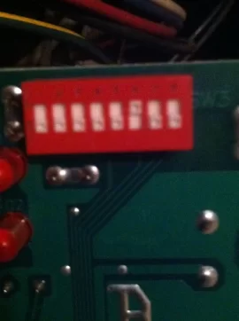

I had posted previous about my problems and having to change out the circuit board. This board seems to run a little different. She runs fine, except for when I have stove running in room temperature. When I lower the room temperature down, the distribution blower kicks off and the flame continues to stay high. The stove gets very hot because the blower isn’t blowing. The old board, the flame would go down and the feed rate would slow down and the distribution blower would remain constant. Does anyone have an idea why ?
