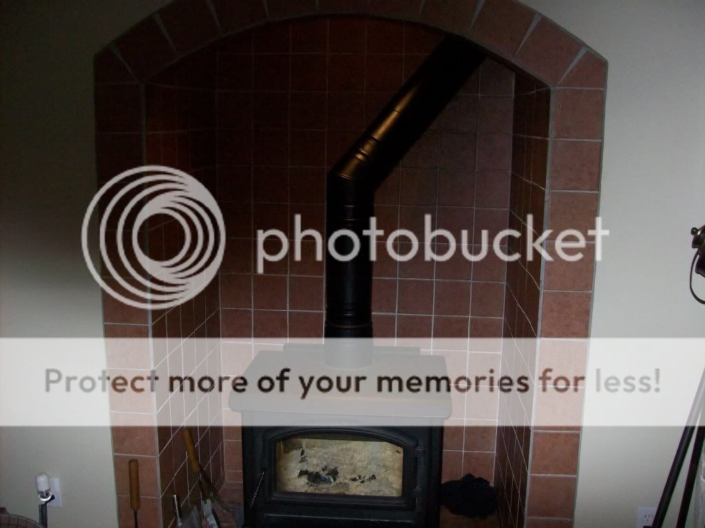

Went from 2 90's to 2 45's this year. Haven't tested it out yet but it appears to have better draft. With the 90's it seemed to be sluggish and not very good secondaries. I don't like the looks as well but if it helps that's good enough. I think that 36" horizontal run was the problem.
