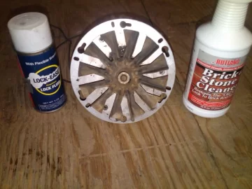

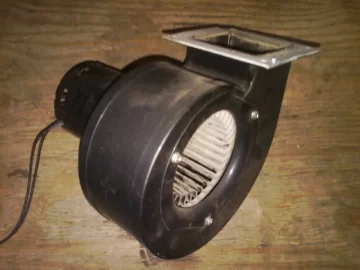

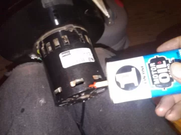

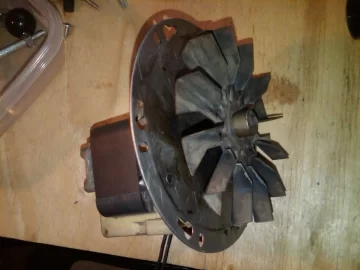

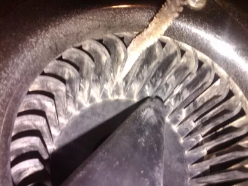

Well, The blowers got a good servicing. See pics
Only 2 bolts on the outside of the Convection Blower and it popped right out.
Using a new small attachment tool kit for the 1-1/4" small vac works great!
Also a very small bottle brush I got from a beer brewing supply store in Salem NH! LOL
The label states to oil every 6 months with SAE 20. I use 3 in 1 Oil which is similar.
The oil holes are not easy to identify. Sometimes there are nice yellow caps but in this case there are 2 holes that have a half round cut towards the front and back of the protruding motor case. See pic of oil spout in hole below:
Then the Combustion Blower blades were brushed and scraped underneath with a razor blade. Then I used Firebrick cleaner to dissolve the soot. Works great. Then I really believe in a nice coating of Spray Graphite to help prevent soot buildup in the future!
Now just waiting for the Lytherm Gasket to pop it back in!
