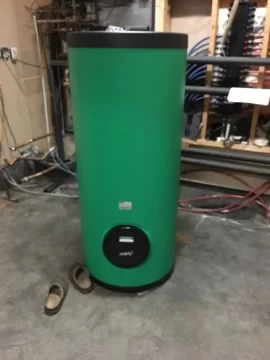

80 gal DHW tank
huffdawg
Oct 3, 2009
1,457
British Columbia Canada
I'm just in the middle of exchanging my 50 gal buderus indirect dhw for an 80 gal eco-king indirect dhw tank. Do you guys think an expansion tank on the dhw side would be a good idea ?

The only reason to install one would be if you are on a city water supply with some form of backflow protection at the water meter. If you are on a well, your pressure tank acts as an expansion tank.

Ya I'm on city water but we are not metered. I just finished up the install, I didn't put in an expansion tank. We'll see how it goes..

You will need one then. That could blow of a lot of water if not. I have seen many a basement ruined this way.
Sometimes even with a working tank but the city bumped up the pressure. Needed a bigger tank.
