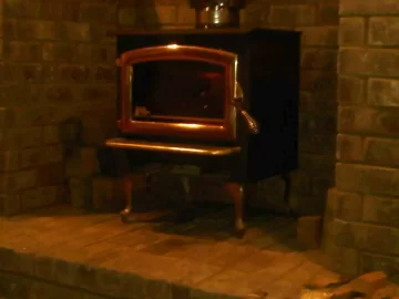

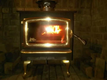

I recently bought a stove and chimney from a man who on oxygen who cannot burn anymore.I will be getting the stove (Country flame BIG) and all pipe. His was a basement thru-wall install so I know I will have extra parts and probably need some. I have a buck 21 installed now using a 6" liner up a double wall pre-fab fireplace chimney. I will be ripping this out and stacking the 8" metalbestos up the interior chase and out thru the flat panel chimney box on the roof. Currently there is NO ceiling in the area directly above the fireplace, there are metal brackets holding the double wall up. I will be framing up a ceiling about 6' up (4.5' above the hearth) with 2x4s and durock (1/2"). Should I use a flat ceiling support box above the durock to hold the weight of the chimney? Is there anything that you guys see wrong with this setup (the new one, not the one thats being removed)? I will be using 8" single wall (about 3') from the top of the stove to the class A. I might be a bit off on my measurements, this is in my parents house a half hour away. The stove is surrounded by a brick fireplace built last year.. Here are a couple pictures of the buck 21 sitting in there. What do you guys think? My only concern this far is the single wall pipe, I might have to go double wall if I get too close to something other than brick. How close is too close for single wall again?
Thanks in advance,
Jason
