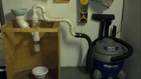

As for the storage. I store them in my basement on pallets and when it comes time to burn I run them through a pellet sifter. My Quadrafire is the only stove I will sift, due to the auger style. It more or less uses a spring as an auger. So the fines accumulate at the bottom of the hopper. The other stoves use a Screw and Cylinder style auger and can eat fines rather easily.
So depending on what type of auger you have, or if you just want to eliminate the dust in the living area of your home, you may or may not want to build one of these....... Just some PVC and a Shop Vac, along with a few little knacks inside. If you run a search at the top of the screen, you should fimd plenty of other threads describing the parts needed. (About $20 in materials/other than the shop vac)
Thanks for sharing, I never would have thought to search for such a system. I'll bet I can do the same thing using my shop dust collector, which uses 4" flexible hose that I can bend into a trap when I want to use it. I have tons of fittings I can snap together in seconds, then pull apart to store on a shelf to save space when not in use.
This pellet thing just might be more fun than I thought. :-)

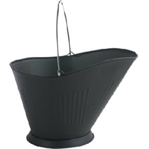

I store my pellets in the garage and basement. I pour the pellets into coal buckets for easy portability. This way, the wife can fill the stove when I am not home. They look nice also.
[Hearth.com] Pellet Storage
I also use a coal bucket. Mine holds about 20 lbs of pellets. I keep it next to my stove - see avatar. Pellets are stored in the basement. Mine has an additional handle attached to the bottom back of the bucket which makes it easy to dump.
