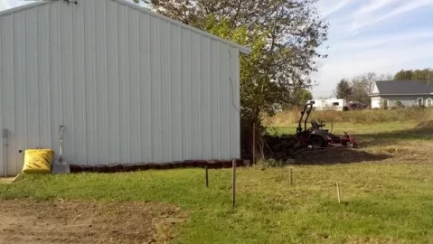

Which way is the prevailing wind? Where are any possible sparks going to go? What do you store in the pole barn? Is it insured, and what does your insurance company think? Can you afford to lose it?
As a Fire Chief I firmly believe in Murphy's Law (if you are not familiar, do a web search). At 10 feet, it is very possible for a spark to get onto/into your pole barn. Be prepared to lose it, especially if the prevailing wind will push possible sparks in that direction. Unless it is all metal sheathed, and you do not store hay or other readily combustable materials, I would think twice about the OWB location.
Your insurance rep might be the best source for that information. If you don't get a reasonable answer (some of them don't really know and are no less than frustrating to talk to) talk to people in your area that have OWB's and see who they have their policy under.
I will add a picture. It is a wood frame with steel siding barn. Prevailing wind will blow smoke away from the barn. It is insured and has misc. tools and such. I will call my insurance company to see what the think. Just looking for some real world comments.

Attached picture. Stakes show where I am thinking of putting it. Wood will be behind building where lawn mower is now. The plan is to extend roof 10' to cover wood, but leave sides open.
