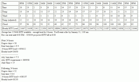

I use a variant of my Delphi tool for calculating how much burn time I need. The Delphi tool uses your latitude and longitude to get NOAA forecast data, and uses plugged in values for heat loss per degree day and boiler output. From that it calculates burn time.
My private variant knows about my tank temperatures and gives me a more detailed set of recommendations as shown below. If I had a convenient way to weigh my firewood, I could combine Jim's calculations with my tool and hit the outer limits of wood-fired OCD.
