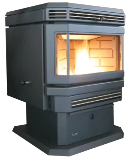

Will the Enviro Mini be big enough?
BrendainNJ
Nov 6, 2010
29
NW NJ
Hi, first-time poster here....looking at various stoves--too many choices! I like the footprint of the mini, as it will be going into an already crowded LR. For this I can overlook its rather "spartan" look. The price is nice as well, since our original budget (until we started looking!) was $2000. My husband plans to do the install himself. We have a 900sf ranch. The stove will be in roughly the center of the house about 10 feet from the hallway that goes to the BRs. The kitchen area is about 25 ft from the stove with a pretty open doorway. Will the stove have to run at "max" to heat this area? If that's the case, I think my husband would feel more comfortable w/a larger stove.
Also considering, in no particular order...Harmon P43, Enviro Empress, M55-wishful at this point, since over $3K, Quad Castille
Thanks for taking time to help!

Have a Mini now for several heating seasons, 10 or 20 tons, a small house
on the OR coast with its moderate climate. It runs on the lowest of five
heat levels nearly all the time (and only runs part of year and only part of the day
when it does run) except during an unusual cold snap or coming home
to a cold house from a road trip. Hopper is supposedly 45 lbs but couldn't hold
a whole sack when first filled brand new. Hopper wouldn't a last a weekend
on low if gone (I never leave it on) and at higher levels you just about have
to stand over it feeding it chow it drains so fast. It chokes up with fly ash
pretty quick (we use Golden Fire) and needs a cursory cleaning of its clog point(s)
after only about 6 bags to restore efficiency and output.
Having said that we love it, works for us in our situation. Had to replace the
convection fan ($200) started rattling and got annoyingly noisy. It barely frosts
here, in a bigger house and/or colder climate its fussy needs and limited output
would get old, the small Mini isn't up to bigger demands. It easily maintains
a comfortable, warm house here, coming home to a cold house is beyond it,
I need to turn on auxilliary heats until up to temperature. The first four heat
settings are nicely calibrated, a noticeable step between each one but 5 seems
no hotter than 4. The pellets feed and burn hotter and faster but the little heat
exchanger can't extract it before blowing out the exhaust instead of into the house
at that high of airflow/fanspeed.
In short, if one's needs are little more than an electric milkhouse space heater
the Mini is quiet, adequate, efficient even delightful...a few bags lasts us a couple weeks
during an average heating season. It can be turned up into a hot little furnace at higher
settings to meet an occasional need but I wouldn't want to run it or have it for that.
It would be noisy and need constant feeding and cleaning.
