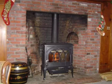

Well, after many weeks of vacillating between installing a pellet stove vs a wood stove, I finally bit the bullet and chose this Castine to put in our old-fashioned fireplace. We've been in this house (a small cape in NH) for 4 years now and have enjoyed many a blazing fire here. Trouble was, though the fire would warm the immediate area, it was a net heat loss for the house. The upstairs and other rooms would get mighty chilly.
Since we put in this stove, the house has been much toastier. Over the past few weeks I stacked another cord (now I have about 1.75 cords) on the back porch and a bit in the garage. Buying seasoned wood this time of year is not such a great option ($295/cord), so in the spring I'll pick up a couple of green cords.
Though stacking wood, and splitting the many logs that needed it, is a bit of a chore, I have no regrets. I just couldn't bring myself to get a pellet stove, which seemed to have the charm of a blow torch. The nice ambience of burning logs-- and the powerful heat it generates-- is worth the extra work to me (but ask me again in ten years!).
During the installation, I was a bit concerned to see the installer squeeze the stainless liner through the 4-inch damper opening. It was evident that this reduced the pipe volume by at least 25%, but he said he did this all the time with no ill effects. It certainly was a less drastic approach than chiseling open the damper opening, as another stove guy told me was necessary a few years ago. As it happens, the stove still has a very powerful draft, so I can say for the record that ovalizing stainless liner through a 4-inch damper does indeed work OK. (We have a chimney that's 17 feet tall (from the damper to the top)-- the back of the chimney abuts with an unheated garage, so it's virtually an outside chimney).
Anyway, here's a photo. I cleaned up the hearth as best as I could before the installation, using a wire brush and some brick-cleaning spray I picked up at a stove shop. I used a facemask (the kind generally used for sanding wood) and it was dark gray when I finished scraping off the creosote.
Andy
  • [Hearth.com] Jotul Castine... installed and burning!
That is sweet. I'll bet that brick gets nice and warm and keeps temps nice and even. It looks like it was made for that stove to sit there too.
Thanks, guys. The house was built in 1986 and really isn't a reproduction. In fact, the family room that the fireplace is in is an ell off the main house and has a modest cathedral ceiling, which you certainly wouldn't find in an antique cape. The one indulgence that the couple who built this house did was the antique style fireplace. Because it's so shallow (the so-called Rumford design) it radiated heat back into the room pretty efficiently when we built fires, and after a few hours the bricks would get warm.
The wood stove puts out a lot of heat, which rises of course. I always turn on the ceiling fan on low or medium, and can really feel the warm air get pushed back down into the room. With the wood stove, however, the bricks really don't seem to get so warm that they radiate noticeable heat back into the room, but that doesn't really matter, as the living room turns into a sauna if I'm not careful.
Hi amazer,
beautiful stove and even more gorgeous installation. I love it.
Enjoy the net heat gain you will have from this stove. Keep us informed of any strange things you encounter running that stove. I bought one too but am still waiting. Hope it works as well for me as for you. It will definitely NOT look as good as yours!!!

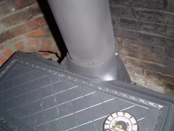

Amazer, Very nice install! I too have a Castine yet to be installed and I'm curious how the installer attached the vertical stove pipe to the collar on the stove. The collar on my stove does not have any type of taper for my stove pipe to fit in and it also seems to be upswept on the side facing forward. Did your installer have to modify the stove pipe to create a better fit? If you could take a pic of the connection between the stove and pipe I would appreciate it. Hope this makes sense?
Wyatt
Wyatt,
Here's a photo of the pipe at the back of the stove. The vertical pipe seems to fit inside of the stove fitting with no problem-- I can't see that the pipe has to taper in order to fit inside the exhaust port (if that's what it's called). Hope this photo helps!
-Andy

Thanks for the pic; I really like your install. Don't know why my dealer said to modify the pipe to fit. It's almost like he wanted me to install the first vertical section over the collar from the stove. As we know, that would allow moisture and soot to drip out where the pipe and stove collar join. I am having it professionally installed in a few weeks, but none the less wanted to know it's done right.
Thanks for your time,
Wyatt
Hi Wyatt,
My double wall extendable pipe did not fit my stove either. I had to buy a 12" section of regualr single wall black pipe and cut it off small (maybe 2 inch) so that the double wall would fit tightly over that. The single wall crimped end fits nicely in the stove. No single wall pipe can be seen (all covered by the stove and the double wall).
Works great.
