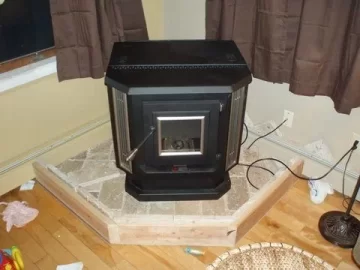

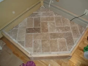

As promised...here are a few pics...
My hearth. Its pretty simple. 3/4" plywood underneath. The 2X6's are eventually going to be painted or stained and will be used to anchor a wrought iron gate. This is to keep my two girls (2 and 3 year old) from easy access to the stove. The stone is a marble-like flagstone (I forget the name). They come in 6" X 12" at Lowes and cut fairly clean with a stone saw blade. The mosaic pattern was easier then I thought it would be.
Pic 2 is the Stove with pellets a-flowing. This is the historic moment before the 1st ignition. The sound you cannot enjoy is my wife standing behind me laughing as I take pictures of the stove. The curtains are about 6 inches from the rear corners of the stove. I was a little concerned at first...but there is really no heat to speak of back there.
