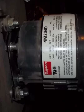

The one I got from Smokeless was equipped with a 60 Hz Dayton motor [see photo]. Seems to be more motor/fan than is needed, even on slowest speed the air inlet needs to be restricted substantially to prevent too high a firing rate, IMHO.

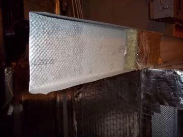

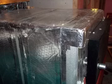

When I charged my tanks the first time my 16'x32' boiler room was up over 90 degF. The room is well insulated but not all that tight just yet, so that seemed awfully hot to me. I investigated and took the skins off the boiler and found about an inch of wispy fiberglass pressed into a 1/2 in gap on the top and sides, and the bottom had no insulation at all. I discarded the top panel, and for the side panels I was able to bend the ears that support the panels out away from the boiler to about an inch and a quarter of clearance. Then I wrapped the boiler with three loops of 1.25"x4" light aluminum channel stuffed with rock wool, and then placed panels of rock wool between the channel loops [see photo]. This brought my boiler room temperature down below 50 degF.
