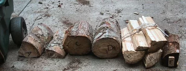

This year I'm going to weigh each of the logs in the photo monthly to determine how long drying takes in my environment. Logs D and E were equivalent in size, E was split. F was wood from last year that was left out in the rain, but will now be covered.

awesome experiment!

WarmGuy said:
OK, thanks for that info.
