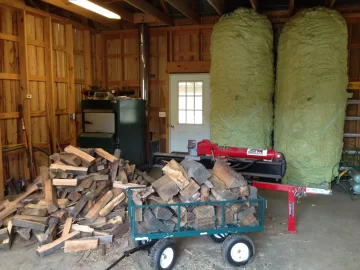

I've attached a pic or my latest feeding processing system which is the best yet!! Now my wife and I can bring 1-2 days of splits in with the wagon, re-split to smaller splits, pile it near the boiler, and load. Easy to load and clean up. As you guys can see from the pic, I've got to go up and over the door frame between the boiler, storage, and lines to the house. I welcome advice about ghost flow, where to put components, if check valves are necessary to work with the Laddomat to prevent weird flows. I'm hoping to hire a pro to do the storage install. Hate it's not up and running this year but ya gotta pick your priorities and sadly getting the storage running got bumped down. Ya'll stay warm up nawth.![5 Years In and Still Learning 5 Years In and Still Learning](https://www.hearth.com/talk/data/attachments/125/125522-432c4184cb426fe98aa4ad2132cf3e72.jpg)
