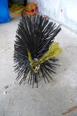

I have an oval Simpson flue, so I cut down an 8" Rutland poly brush (see pic). That took a while as I wanted to make sure it was just right, especially when the bristles have to swap direction when you're pulling upwards. I used the electrical conduit method for rods (thanks Gooserider and others) - three 10' 3/4" conduits, one PVC 3/4" to 1/2" NPT (female), one brass 1/2" NPT to 1/4" adapter. Use pipe solvent and glue to glue the plastic adapter, insert the brass fitting, then threadlock to secure the brush to the first section of conduit.
I sanded the ends of the conduit so they came apart a little easier, then drilled a hole though the assembled joints. Instead of a bolt I used a pin with a clasp (see pic). Just a little quicker and less fiddly than a nut/bolt. Rope attached to the brush eyelet, then hitches at the top of the brush, and hitches on the conduit. I did the extra hitch on the top of the brush because I figured than if I did have to use the rope to pull the brush out, this would help keep the brush aligned.

The sweeping went well - I didn't feel that I was using too much force, and the pipe certainly ended up clean. About $90 in costs, so I've already saved $60 for a sweep..
