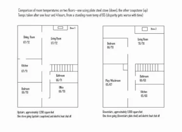

I agree with you, which is why soapstone works better for our application: with a steel stove, there's a blazing hot spot in the middle of a space and, while the main area heats up quicker, it takes much longer (I cannot figure out why) for the rest of the rooms to follow. With my soapstone, all the rooms are closer in temp. For example: where my steel stove is, the main room will be 75 and the other rooms 65 (including the room RIGHT to the side of the stove). Where my soapstone is, the rooms are always within 5 degrees (including the room WAY out back). Although it might take an hour longer for this to happen, it's worth it since I don't get blown out of the main room while having cold back rooms. It's also much, much harder to keep my steel stove even--there are many more 'peaks and valleys.'
I've attached some sweet diagrams.
S

thinkxingu said:
Highbeam,
S
I checked out those sweet diagrams and I think your biggest issue keeping that steel basement stove from heating the adjacent rooms is the open staircase and the whole heat rises thing. There's just a path of less resistance for the heat to scramble upstairs and for the cold to stay in those rooms. I look at this situation by imagining the basement being full of water and the stove of your bubbling out air. Those air bubbles will rise to the ceiling and fill the ceiling until they escape up the staircase. No bubbles will make it into adjacent rooms with that big hole in thte ceiling. The upstairs stove has a much easier time distributing the heat sideways since the hot air has no escape route.
