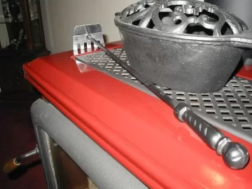

I make these all the time for the stubborn group that cant get away from pokers and hooks.
I make these out of 1/2" , 3/8" & 1/4" round cold rolled steel , grind the tip and O/A the ends.
24" is about standard for a modern wood stove and 32" for the bigger old timer tank stoves and fireplaces and 4' and 5' for them ole' out door wood boilers.
*sorry , no welding here either* :long:
(Pictured is 32" )

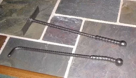

I made my own. I posted them before but can't find it now. I also built a matching ash shovel but no pic. Shown is a poker and ash rake. They work great and I'm really, really pleased with the heft, grip, balance, length and all that. I hope to keep and use them forever.

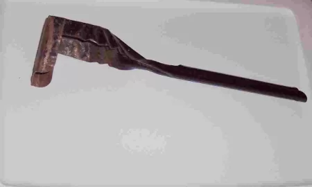

I figured I'd resurrect this thread than start a new one. After watching the Canadian wood burning videos I called around local hearth shops looking for an ash rake. No luck at all. So with the storm going pretty well in Central NH I thought about how I might make one myself and I'm a 6.5-7, (basically a D-), on the handiness scale. After looking around for what I could find I made this one.
Parts list consists of rusty old ash shovel, a small hacksaw, a pair of wire cutting pliers, two sheet metal screws, and a brake made from sticking two firebricks together. It works great in the Vista but I think one might need a longer shovel for other stoves. A pretty fun 15 minute project.

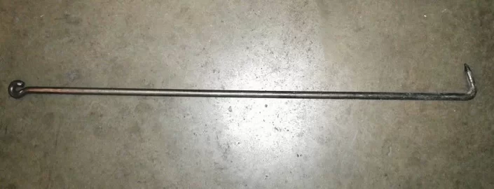

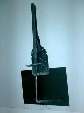

The first 2 are home made. The poker/hook was made by my wife's family, probably ~ 40 years ago. The ash rake was made by me last week.
The shovel was bought from the hardware store about 6 years ago.
The metal plate on the wall was from our woodstove pedestal, removed to put in the ash dump option. Keeps the hot, dirty tools from touching the wall.
