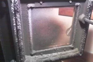

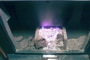

Crazy Amount of Ashes in My Burnpot
joefraser
Oct 4, 2009
87
Somersworth,NH
I am burning Bayou Pellets (they came free with the stove). I am pretty sure I cleaned the burnpot this morning so at most this is 11 hours on heat setting 2. Worst case I forgot to clean and it would be 21 hours. Sill isn't this a crazy amount of ash? There was also ash all over the door too. Do I need to adjust my combuion rate or something? I\Possibly too much draft or not enough? I really don't understand what to look for when changing the settings for feed and air etc.. I went through about a bag of pellets in 12 hours on setting 2. I've been doing all the recommended cleaning.
For the pics the stove was in shutdown for about 5 minutes thats why the flame is low.

Englander 25-PDV by the way
Bayou Pellets Hmmmm!
What other pellets do you have available in your area? I would start looking and calling around quick before the cold really gets hear.
Post some of them and will tell ya what the good ones are.

I am guessing that you have some crappy pellets, I had burnt this awful brand called Manufacture Trader, had the same outcome in my harman stove. I would pick up a few bags of anything else and see if there is a difference.

Those pellets must be made of cardboard and bark, way to much ash. Try another brand, I think you'll see a big difference.

It's the pellets. I've had the same stove for about five years, and have burnt about seven different brands of pellets. I got Michigan Pellets three years ago, and they produced ash just as bad. I would clean the burnpot just before I went to bed, and the ash would be piled up against the window by the morning. All other brands of pellets burn fine.
I changed the settings to 5-5-1 this morning. Seems to producing a little less ash. My stepson emptied the burn-pot before I got home so I don't know for sure. Thanks for all the help. I Thinks it's alot to do with the pellets. I'm going to try some other brands and see if the do better.

If I didn't know better...I would say you have a batch of first edition Maine Woods pellets....
Try a decent pellet and see what happens.
