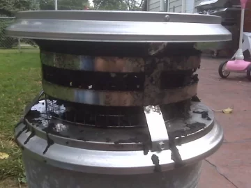

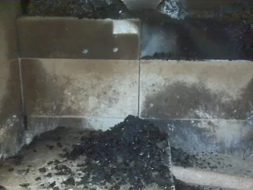

First, welcome to the forum! Like a previous member asked, what is your setup? Do you have a full liner or venting it into an open chimney? It's black and very shiney. When I cleaned my chimney this year after the first season of burning, it was BAD. We were very lucky it didn't catch fire. Here's a pic of the chimney cap...you should be able to see right through it as it's lined with wire mesh with 3/4" squares just to keep the critters out. Notice the drips along the base, that's the creosote as it built up from the cooling effect as the gases exited and condensed...too much moisture in the wood and not hot enough fires to properly heat the flue.
The other pic shows a pile of it in the stove as it was brushed off the liner during the cleaning. Don't be afraid of creosote, but rather knowlegable of it. You're not gonna be 100% creosote free. One thing I have learned from Hearth.com is you NEVER stop learning, you just become more educated; burning gives you the experience.
