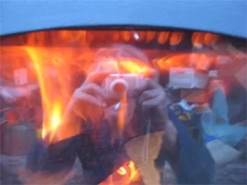

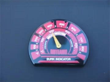

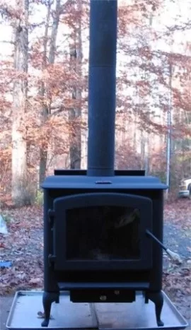

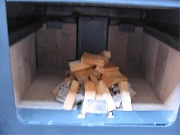

Test fired the 30-NCL this morning in the outdoor burn lab. It was no surprise that with a four foot single wall stack in a fairly high wind that a stack temp of 200 was as high as I could get it. Lousy draft but even at that secondary went to work at a stovetop temp of 300. Oh, and keeping falling leaves off of your wood stove can be a real PITA.
Brush off leaves. Straighten the pipe. Brush off leaves. Straighten the pipe...

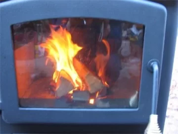

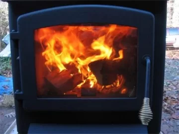

Kicked'er up to 400 for a while and then idled at 550 for an hour or so.

Congrats, BB. That's quite a lab setup you got there. Whens she moving inside?
Wow! That is a big fire box. You fit right in there. :lol:

I had to squat down to get in it and damn it was hot.

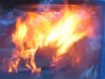

Looks good brotherman. Is it just me, or is there something unbelievable cool seeing those flames licking out of those manifold tubes.
Yep. Darn thing has four tubes. When they all fired at once I was too busy sitting on the ground in front of it watching to mess with a camera.
Even more incredible was that between 350 and 400 the exhaust went perfectly clear and stayed that way. With a 200 degree four foot stack! I may buy another one to keep outside and burn trash in. :coolgrin:
Yeah that's the unbelievable part too. I couldn't believe that once the secondary was active, there was zero smoke out of stack. It stays that way for the duration of the burn too.

BB , Whats the metal bracket up front bottom ? Air inlet or something to prevent log rolling at the door ?

That thing is interesting. It has a .38 caliber sized hole in the other side of it aimed right into the lower middle of the firebox. It is the primary air feed. Primary air comes in through it and also over the glass for the air wash. The primary air comes in from the back, moves under the length of the fire box and is distributed to the little tower and to the airwash by two channels up the front sides of the firebox. Secondary air has it's own inlet in the bottom rear and comes up a riser in the center back of the fire box and is distributed to both sides by channels around the top.
I can't wait to see the havoc the stream of air from that lil hole creates when I hook it up to the monster drafting liner in the house.
So far I love the design and the big firebox. I ain't too bashful to say that I wish the steel all the way around was twice as thick. Of course I am used to the old pup that was built like a Sherman tank and the only fire brick was on the floor of the firebox.
Two hours ago the stove body turned Golden Glow Brown. Black door and legs. I haven't decided if I am going to put the brass trim on the door and the top lip and ash lip yet. I just want that SOB in the house and the install finished.
