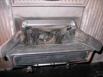

Hello,
I have a question about my Harman Accentra 2 "burn pot". On mine, there are holes on the bottom of the burn pot, I mean where pellets are 'travelling' from the screw to the ash box, and there are holes on the top of the burn pot above the srew. Do you have such holes on the top of the burn pot in the USA ?
In R4 and R7 release of Harman's manuals there are only holes on the bottom of the "burn pot" on the pictures, do you ever saw or heard about that specific model (for France, Europe...) ?
About Accentra "FS", what means this "FS" (Fire Stove ?) ? Is it connected with the direct drive of the srew, or is it still Accentra 2 for the direct drive ?
I think it is now Accentra 2 (chain and direct drive) because in the past another design was Accentra 1, or Accentra [nothing] ?
Last question is about the approx date of Accentra direct drive on the US market ?
Thanks a lot, and excuse-me for my poor american language...

We have an Accentra-2 FS (free standing). The holes you describe on you burn pot sound just like what We have on our Accentra. In our manual, on page 23, you can see the holes on the top of the burn pot in Fig. 39 and 40. We also have the holes on the bottom near the auger screw. I am not too sure the stove would burn very good without those bottom holes. It seems like lots of air is coming out of them. I think my manual is for R5. I don't know about dates that the drive was modified? I didn't know there was such a think as Accentra 2. When we bought our stove, I just thought it was an Accentra.

From what I remember there are four (maybe 5) complete rows from the top of the burnpot down towards the auger.... near the auger there were less holes (in the older ones) I believe groups of 4 holes in 2 rows near the outer edges of the burnpot....

The 3 or 4 holes at the auger help with the carbon build up in that area. The older model harmans do not have these holes and carbon would build up and was hard for the owner to remove.

Attached is a picture of the burn pot (200kb), is it the same in the USA ?
The top part with the holes seems to be welded afterwards ?

and Burn pot on Fig.39 that is different from mine !

Alot of good info here! I believe the only difference between a Accentra FS sold in the US and an Accentra FS sold in France is that the French model has electronics to run on DC, while the US models run on AC.
As for the drives. There are new drives in ALL of the older chain-drive models....the newer drive mechanisms are called UL (Ultralight), and there are two flavors: Direct Drive and Indirect Drive. Basically, no more chain drive on the most modern units. No, you cant pull (easily) an old drive off and stick a new one on either! The direct drive is in Accentra Inserts, P61, P61a, P38, P68, PF100. The Indirect drive is in the Accentra, Advance, and the XXV.
Those little holes were once put there to introduce air to the front of the auger to eliminate carbon accumulation (it helps), and to alleviate the "sticky stove" syndrome, that happened with a few rare units (didnt help this). New instructions say to seal them up with furnace cement in tech work (with sticky stoves), so, Im thinking they werent found to be much help.
