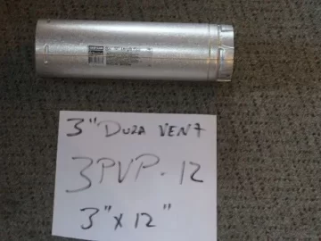

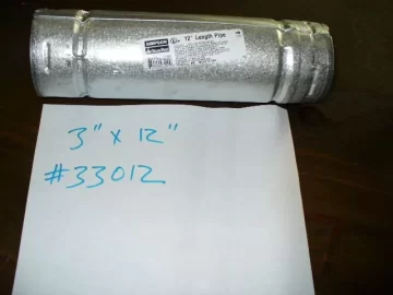

Is there a sure fire way to identify the brand of these pipes? I don't see any numbers or labeling on them?? What if I post pics? Could someone identify them?
Thanks-John
the way to identify Pellet Vent or Corn Vent to Pellet Vent Pro is that Pro has welded seems and not crimped. Pro looks a little better without all the crimps.
The first pic is Pellet Vent Pro 3PVP-12
The second pic is Corn Vent #33012
Good information- I will check when I get home- Thanks - John
