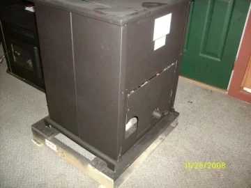

Now Class, today we will tackle the combustion blower. Please remember all Breckwells are the same on the inside except the P-24 where the Combustion blower is on the back wall.
These pics are the Big E with the panels and then with the magic touches of a screw driver, the side and back panels are removed.

As you can see with the blower housing that the motor is held on by 6 sheet metal screws with 1/4" heads. Loosen the screws about three turns. Take the motor and twist it and pull. It should come right out. Remember fire is hot so if you just shut the stove off it will be warm the blower will come out and you can clean the fins and inside the housing. With some skill and luck you will be able to get a 3" brush into the venting from here. Now just do everything in reverse to put it all back together. Watch the gasket it is flimsy and the replacement cost is around $12.00.
Please take all safety precaution.
