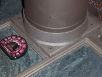

The stove pipe collar is attached to the stove by 4 allen head screws. Undo those and as Todd says, you just remove the whole pipe section betwen the stove and the thimble. Slick as snot. Takes 2-3 mins to take apart, cleaning time, another 2-3 minutes to reassemble. No one wants to move one of those bad boys once they're in place. :ahhh:
  • [Hearth.com] Woodstock Soapstone wood stove install

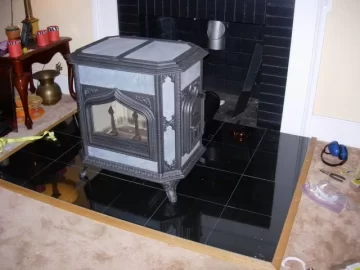

Woodstock is great to work with. Just set my new Fireview on the new black granite hearth and I am working to connect the double wall stove pipe to the liner. Here is a picture of the work in progress.

Fireview is what I am considering.. Odd how the one stove has a 7" flue size.. I like the top pipe system that was posted.. Your hearth looks sharp with all that polished granite...

Thanks, Fireview has a 6" flue size and I am running double wall stove pipe for the close clearance and one piece is adjustible so the stove (heavy at 475 lbs) does not have to move.
