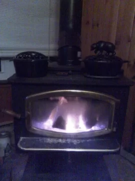

Well now I have two steamers on my Avalon and one has a trivet the other does not. The one without steams away and I fill it twice a day...not a problem. The other with a trivet does not steam, water boils a little and I fill it about every two or three days. Stupid me ordered another trivet for the other steamer but I might not use a trivet at all since I am getting steam from the steamer :lol:
I know a trivet is supposed to protect the stove but it seems I am adding more moisture in the room without one, no dry throats. Should I keep both off?
Help
I took a pic but very dark this time of night..... :)

You pretty much summed it up...save the stove, reduce the moisture out - risk the stove finish and have a steamy tropical atmosphere.
I can't tell you what to do, but I don't use any trivets - stove top gets a few scuffs and a bit of rust - this can be minimized by not scraping the steamers across the top of the stove and being careful when they are filled. But overall - just the way it is when humidifying with stove top steamers.
The trivet allows air to take heat away before it gets to the water. The steam is what you want so you need the heat.
