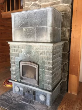

Does anyone happen to know the model for this Tulikivi? We just purchased a home with a 25 yr old Tulikivi. We'd like to try to find an owners manual online to learn how to take care of it and burn properly. All your Tulikivi tips are appreciated. Thank you!

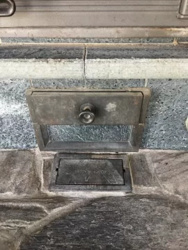

You are lucky that's a masonry heater. It looks like it has a few cracks here and there - just ignore them they don't effect performance. There isn't much to take care of. Inspect the soapstone in the firebox for cracks and damage. To clean it you remove those 2 little round doors and stick a vacuum head in there and suck up the ashes. They burn really hot so there won't be much ash.
This thing should last a long, long time. How to use it? You build 1 or 2 fires per day. The fires burn for a couple of hours. The heat energy is absorbed into the mass which than radiates the warmth for 12 to 24 hours. There is a damper somewhere on that masonry heater - this is a knob that you turn or pull out to open the air passageway. It is probably at head height although sometimes they are near the ground.
You open this passage way (pull the knob) when you are ready to burn. When the fire goes out you close the passageway (push the knob in) thus preventing your heat from escaping up the chimney.
There may be something you have to open to get air to the fire - or maybe it is built-in. The fire has to have air - it looks like it may be built in. The best way to build a fire is the top-down method - that is little kindling/paper on top such that the fire slowly burns downward. This way more of the wood's released gases are burned.
Oh ya inspect the grate, too. That little ashdoor below the firebox will have a pan that you can pull out to dump your ashes. The grate can be replaced if worn out.
The way this Tulikivi works - you load the firebox with firewood, open the damper, open the firebox air supply (unless built-in), burn your wood (1.5-2.5 hours), and close the damper - done. You do 1 or 2 fires a day depending on how cold it is and the size of the cabin.
Your masonry heater is a contraflow type - that is the heat goes up into a chamber above the firebox, than goes down one of two side channels, and than exits into the chimney behind the heater. Below the firebox are channels for the down coming exhaust to travel through - (that is the exhaust that is coming down the side channels).
