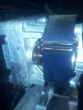

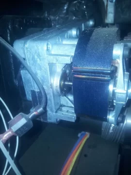

So the other day I noticed the top auger was 'rubbing' up against the tube so I took the augur our and reseated it per the instructions on the Englander site (not making any noise now). While doing that I noticed the top auger motor had quite a bit of grease leaking out and the bottom had a little bit, is this anything to be concerned about?

I had the same thing with my motors, i was still under warranty, had them replaced.

I sent off an email the other day to ESW and they just said it happens when they get to hot, didn't mention anything about replacing them.
