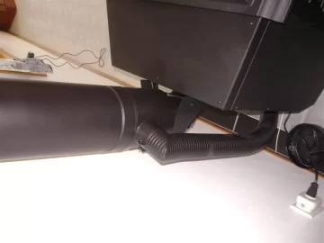

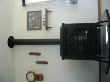

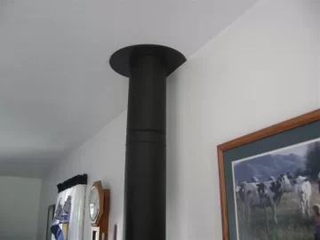

I have a vert. install but 8 ft ceilings. Will try and get pictures posted for ya when I get home.
here ya go

Install was done by dealer. $500 labor. Two story house 28' of venting. Selkirk direct temp.
No difficulties with insulation or shingles. Clearance to combustibles is one inch for selkirk direct temp. Vented through closet on second floor and boxed in.
As far as cleaning the vent this is my first year I haven't cleaned it yet, and I have the top vent adapter on the stove so I suspect clean out will be slightly messier than if I had a tee.
