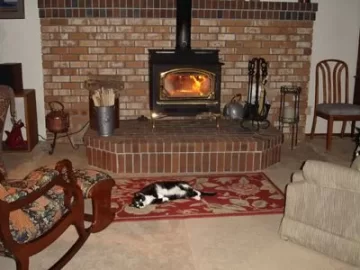

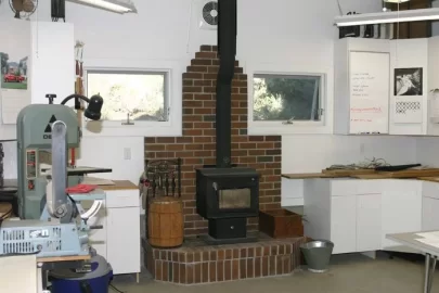

Masonry's an option, perhaps...depends to a certain extent what's under the stove now, but maybe not so much. One of my installations is masonry on slab, the other's masonry on wood subfloor. Rick

what type of bricks did you use solid?for your pad it looks very nice.

Everything that you see is solid brick, but the bulk of the hearth in each case is made up of typical concrete block laid in mortar to quickly establish the bulk of the hearth, then the brick "facade" is applied in mortar around and on top of the blocks...if my description makes any sense. It would be referred to as a "solid masonry" structure, although there certainly are air pockets down inside there, as it's not just one brick stacked upon another, but nothing combustible was used in either one. Rick
