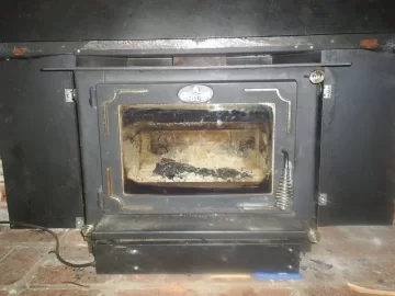

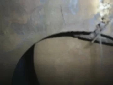

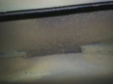

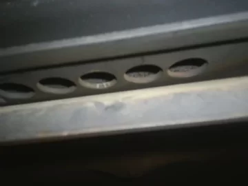

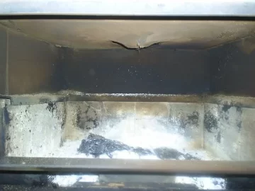

Pictures of my insert PRE liner install.....
Its an osburn, and while I had it out today I forgot to look at the model number.....
I love this website!! NOTE! The crack is not in the top of the stove, it's in a Baffle area and has no acsess to the outside world. I also welded the crap out of it, and reinforced it with a 1/8'' steel plate.
