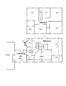

I am in the same situation as you and made a decision to buy a fireplace insert over a pellet insert. I enjoy buring wood but am tired of letting my oil heat up the chimney even with the glass doors closed. My floor plan sounds a little like yours. I am going with either a Hampton HI300 or Jotul C550. Don't be afraid of too much heat if you have an open area. You can always find ways to move that heat around or burn at a lower setting (less wood in the stove).
The reason I am going with a bigger insert stove is for overnight burns.
  • [Hearth.com] Wood stove insert a good choice?

If your floor plan looks like mine (above), you should have a natural cold return flowing down the stairs from the 2nd floor.
I don't have my stove installed yet, but i do know from past winters when we have the baseboard heat on downstairs and off upstairs, there's cold air pouring down the stairs into the hallway.
Other post from this forum suggest to put a small fan on the floor in the hall area near the door that leads into the Family Room. The air flow (cold) will be directed to the fireplace insert as my cold air return. The theory is the cold air below heading towards the stove will move the warm air above into this hall and up the stairs creating a nice flow. As far as the Kitchen, there's enough of an opening where the air should just move in that direction.
