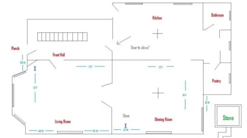

My room with the stove on #3 gets like 80 I'm still trying to get the air movement down :) but I need a week of straight cold to see what works best. Below is my floor plan I need to figure out if closing the door between the kitchen and hall with help move more heat up stairs and then just point a table fan in the dining room towards the kitchen.

Sounds like I am going to have to move the thermastat for my oil furnace to a point farther away then the pellet stove heats yet will still come on in the real cold weather. Same with the tstat for the for the pellet stove, try different spots in the house and see where it runs the best to keep the house at a good temp.
