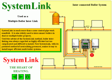

Hi.
I currently have a sealed central heating system based on a range cooker/boiler. I'm planning to buy a wood stove with back boiler and have it hooked up to the said system. My current system has 3 zones - living,bedroom, and cylinder hot water. I want to be able to have the stove and/or range heat individual or all zones. My plumber tells me that connecting the wood stove into the existing system would mean that the central heating system would have to become open which might reduce its efficiency. To solve this problem he is recommending an interconnect system which is a central unit which takes its heat source from two different independent sources (range and wood stove) and allows me the flexibility I need whilst keeping the current sealed system sealed . Each zone would have its own pump. I have attached a couple of pictures to illustrate the potential layout. . As the outlay is considerable I wanted to get some advice on whether the gain would be substantial enough compared to simply connecting the wood stove into the current system, going from a sealed to an open system and using my current zoning setup. Any help or advice would be much appreciated.
rgds
tom

Wow.
I'd stick with a closed-loop, pressurized system and a storage tank rather than trying to get everything to cooperate with a heat exchanger. Quite frankly, I've never seen a range that doubles as a domestic heat boiler, nor have I seen a conventional wood stove rigged up to heat water, much less an open-loop one. What you seem to be proposing would be a technical challenge and a difficult balancing act, IMO.

That b/w diagram looks like something out of the late 1800s or early 1900s. I can see the heat exchanger and the expansion tank in the attic. Old school.
I think you could accomplish what you're trying to do with a lot less equipment, plumbing and potential headaches with a different wood-burning appliance.
