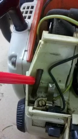

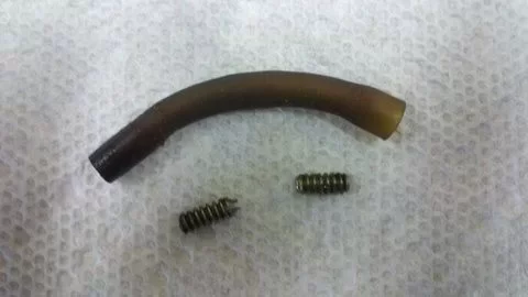

Finished my first Carb rebuild yesterday and it felt great. Well for about 15 minutes then saw died again. I checked the gas since i didnt put much in and when i took cap off there was a hiss which got me thinking about the vent. Put cap back on and it fired right back up
. Pulled vent hose and it was plugged up. I went and ordered new hose and asked them if they could check RPM after i rebuilt the carb and they adjusted it and check RPM for free!!
