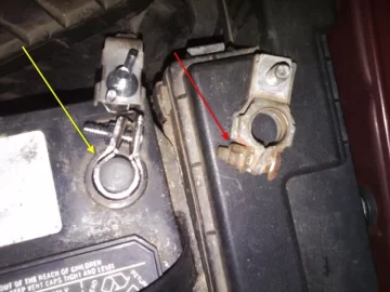

See Pic 2
Red arrow is old OEM Toyota negative battery terminal
Yellow arrow is new STAINLESS STEEL battery terminal for $3.39
(The OEM foreign made pot metal battery terminals are not made for NE weather!)
P.S. My friend thought he needed a new battery on his truck because it would not start. However after I replaced his very rusty battery terminals with two new ones, it starts every time!!
