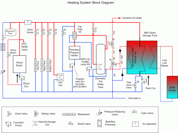

I am modifying my off-grid setup described in this thread https://www.hearth.com/talk/threads/12118/
Adding 600 gallons of unpressurized storage and several flat plate collectors (3-4x10, 3-4x8, 3-3x8).
Configuration will be very similar to Nofossil - seems to have least number of components and smallest electricity draw - Thanks Nofossil
Question - referring to NoFossil's diagram http://www.nofossil.org/heating.html,
Would an indirect water heater (e.g. SuperStor) or a tankless with a pre-heat option (e.g. Bosch 1600PS) be more efficient?
I guess the main question is how to provide DHW at 120F and radiant down to 90F using the least amount electricity with a Seton W-130 and several flat plate collectors and as little propane as possible?
Thanks,
Steve
