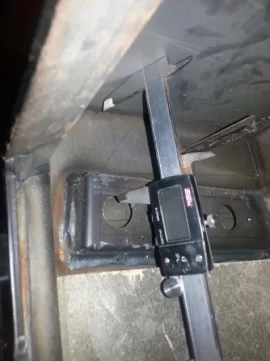

I first measured the height of the hole on the left side.
[Hearth.com] 17-VL crooked air tubes

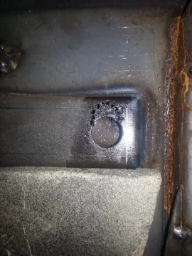

Then drilled a few holes on the right side.

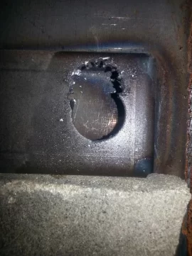

Pulled out the chunk of steel with vice grips.

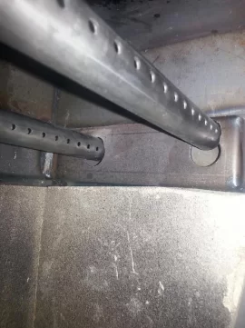

Then ground the hole smooth and fit the tubes. Both had to be raised to get them perfect.

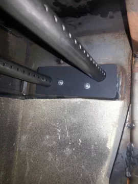

Made a new 1/8" thick steel cover plate and painted with high-temp ceramic paint.

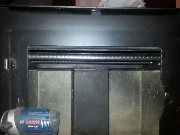

In the end they are both perfectly level!
