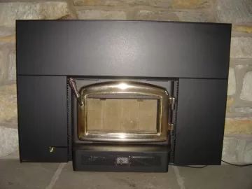

Bogman;
I am on my second Regency 1200 (my first was actually the 1100 model - pretty much the same thing) so let me offer some things I know about them.
1. I can assure you this is a well made and effective insert - it will pay for itself in a few years based upon tradional fuel prices.
2 Pros - well built nice design, low maintenacne, big viewing window, high heat output (MUST get the blower)
Cons - small fire box/burn time (3-4 hours max), ceramic baffles on top of firebox will become brittle and crumble
(but these are covered by the lifetime warranty)
Overall I am very pleased with the unit.

Thanks for the post and feedback on the unit. I like how it looks in the fireplace, nice.
I choose Regency not initally because of its quality but because it was the only insert that would fit into my fireplace without any major masonry work. Other brands such as Avalon or Vermont Castings had similar products but were just too wide.
In any event, I'm still hounding the dealer to get me a revised price so I can get this thing installed.
Do you mind me asking, how is the fireplace sealed off from the room? Do you have a damper block off plate or is it sealed around the trim?
They insulated/blocked the stove pipe heading up the chimney after taking out the old damper. The unit is MUCH less drafty the original fireplace, so it is a added benefit when not even burning. The stove location in my house is the lower floor of a split level, so it can get quite chilly there. The remarkable thing is how well the upper floor gets benefits of the heat as well....I have a stairway with a 2 story ceiling and a ceiling fan at the top, you can feel the 'warm breeze' in the stairs in winter when the stove is cooking.
I would also recommend the 24kt gold door option, it makes it look real nice and its shine lasts a long time (I had my old unit for 5 years and it looked like new when i sold the house)
