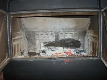

The flue goes straight up the top in the middle here is a picture of the inside of the stove. Thanks again

Whatever that back baffle is looks warped and crocked, could have something to do with it.
Yea I thought the same thing when I bough the used stove, but it is solid, and looks like it factory.. I will try bending it up next time the fire is out.
