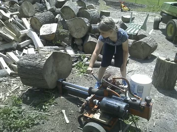

It is pretty amazing what little splitters can do. I split 5 cord with one this weekend and only had to set a dozen or so rounds aside for my bigger splitter. It is nice to be able to use 2 hp of electric instead of 35 hp of diesel for the majority of my wood this year. For a couple hundred more than what you are looking at, Rampslitter will deliver their 12 ton electric.
  • 12 Ton Log Splitter
